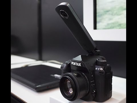

Ricoh has a demo of Multi-Imaging Technology which could be used for construction training, starting with still 360 images combined with still images and standard video.
Love that demo video! There is no question this can play a role in what we are building out for the future as far as training on equipment that goes into a building. Thanks for sharing Craig
The main idea is embed high-resolution images into the view of 360 sphere. That is a slick demo by Ricoh, but you can do similar things cheaply with a normal camera and your own software or inexpensive software like pano2vr or krpano.
