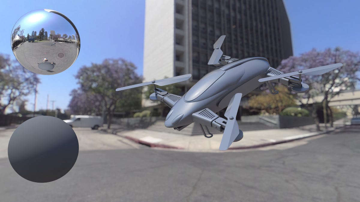

This is another option to output EXR files that you can then put into Photoshop to adjust the color/light for difficult lighting shots.
