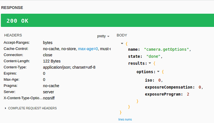

You mentioned that the exposure value was changing. There is an error in the script or command line parameters that is preventing the options from being set.
I looked at the exposureProgram value after running the script.
If I send this command,
{"name": "camera.getOptions",
    "parameters":
    	"sessionId": "SID_0003",
    	"optionNames": [
            "iso",
            "exposureCompensation",
            "exposureProgram"
I looked at the program script a bit and can’t figure out what the root of the problem is.
