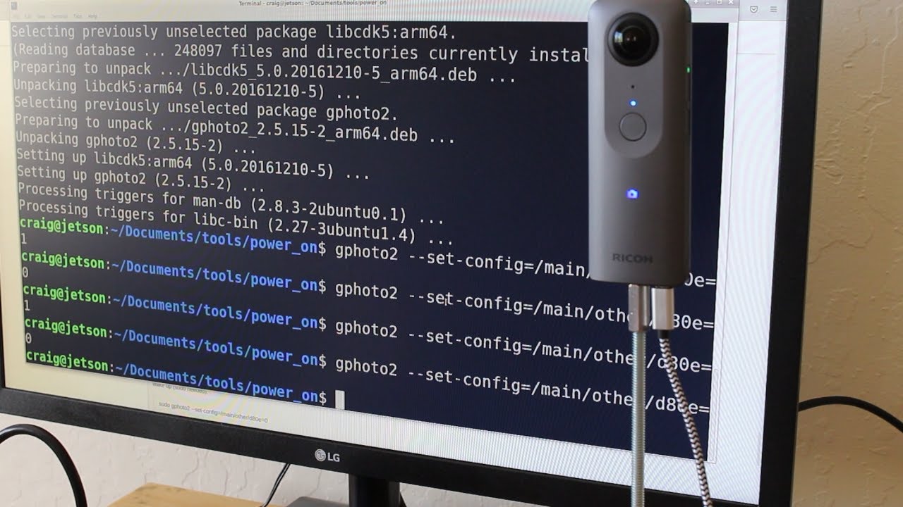

Thanks to @Hugues , here’s my successful test of waking the THETA V up from sleep with gphoto2 on Jetson Nano.
  • used apt to install gphoto2 from pre-compiled binaries onto the Nano
  • I did not need to use sudo to wake the THETA V up from sleep
  • used JetPack 4.4, THETA V firmware 3.70.1
This is in addition to the technique to modify ptpcam with code from nickel110.
I still intend to create another video that shows libptp2 compilation on Jetson with all the modifications from nickel110.
