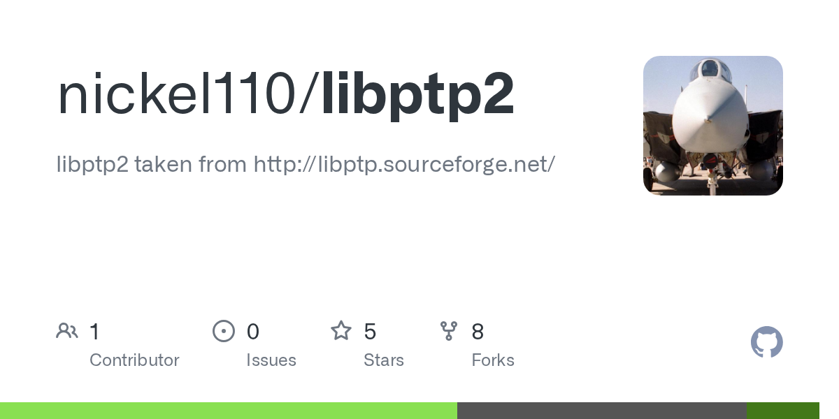

Update to nickel110 fork of libptp2
I noticed that nickel110 added a new commit to his fork of libptp2
I downloaded his new version and tested it on Ubuntu 21.04
it worked fine to wake up the Z1 and V with a --reset-delay=2000. Note that in my test below, I renamed ptpcam to theta to the original ptpcam unmodified for testing.
All tests below succeeded in waking up both cameras from sleep and putting the cameras to sleep.
