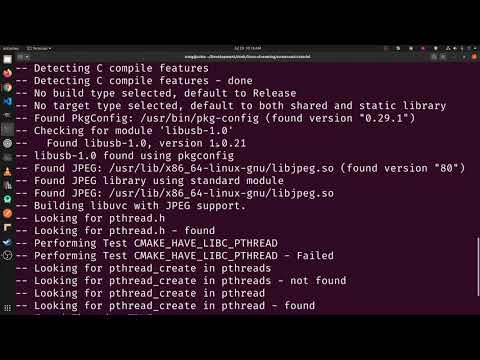

I recently recorded the process of downloading and compiling On Ubuntu 21.04 x86.
This is in addition to the previous video walkthrough with 20.04 (slightly older repo)

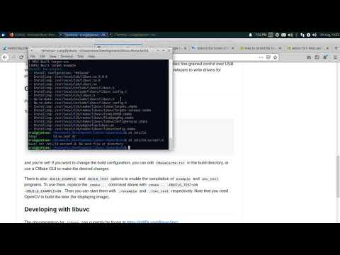

This is the build on Jetson Nano
I can try to show what works on common systems, but I am unable to help with your specific configuration as I cannot replicate the problem you have.
