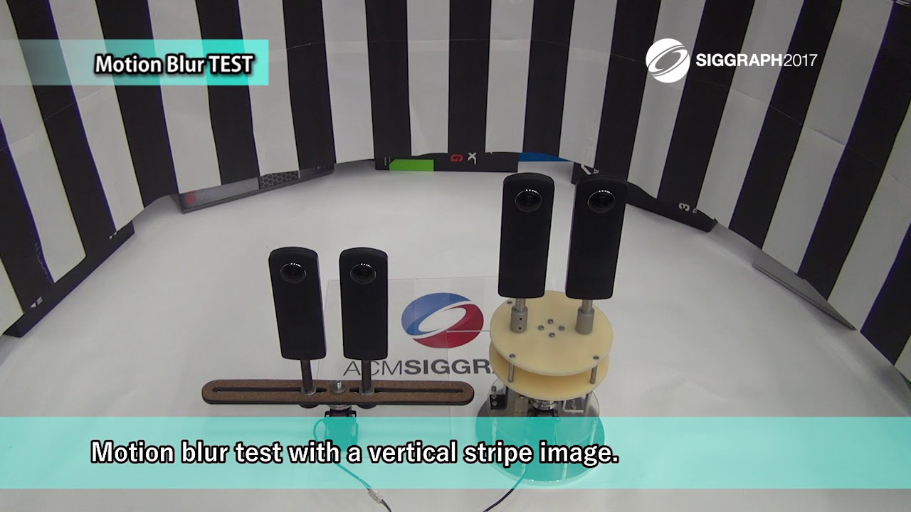

Shot some still successfully with 2 theta Z1 but focusing on Theta V with the TA1 microphone repositioned for more accurate ambisonic sound using a custom made extension cable (Good thing we’re close to Akihabara in order to find a 6 pole audio plug/jack!!)
Just curious what any others may be doing.
This is the latest state of the art.
Most of the people are experimenting with live streaming for telepresence. There hasn’t been too much activity in stereoscopic still images, except to efforts with trying to use two cameras for measurement.
Most solutions to capture a space in 3D use a single camera and attempt to build a point cloud.
Well… I’m thinking of Pre firmware update perhaps where there was little to no stabilization.
My theory is that the stabilization won’t be exact same for 2 cams and could prove uncomfortable for the viewer’s eyes.
re: “This is the latest state of the art.”
Wow! That’s pretty fascinating! Not quite what I’m trying to do but gives me more ideas!
You may be able to experiment with turning off Zenith Correction and changing the stitching. I don’t know too much about 3D stereoscopic photography. The information below might be irrelevant.
