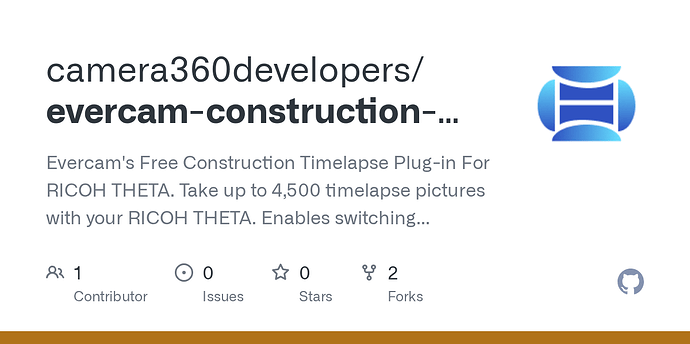

Evercam’s Free Construction Timelapse Plug-in For RICOH THETA
Open source community project from the team at Evercam
Take up to 4,500 timelapse pictures with your RICOH THETA. Enables switching between timelapse and single still image mode without the use of a mobile phone.
