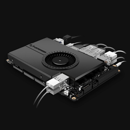

gst_viewer shown Can’t open THETA X on lattepanda sigma (x86 CPU)
Hello, i have been trying to view the video stream using gst_viewer from libuvc_theta_sample on lattepanda board. I am using ricoh theta x but I don’t know why when I run the get_viewer the result always ‘THETA not found’. could you help me debug this? ThankYou

  • Intel Core i5-1340P - 12 core, 16 thread
  • Intel Iris Xe Graphics
opinion: should work really well.
Hello mr craig, I’m sorry for the late response. Yes, my lattepanda is using GPU embedded in the CPU (CPU Intel Core i5-1340P and embedded GPU Intel Iris Xe Graphics)
