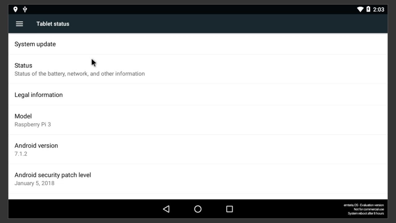

For evaluation purposes, I’m going to try the demo version of Emteria OS Android 7.1.2 on Raspberry Pi 3.
There’s a couple of interesting pieces to this, including the OpenGapps.org site.
As the Emteria OS will reboot every 8 hours and the commercial version is 69 Euros per device, it’s unlikely this is a long-term solution. However, it may be useful for testing.

I’m able to access the Google Play store with Emteria.
