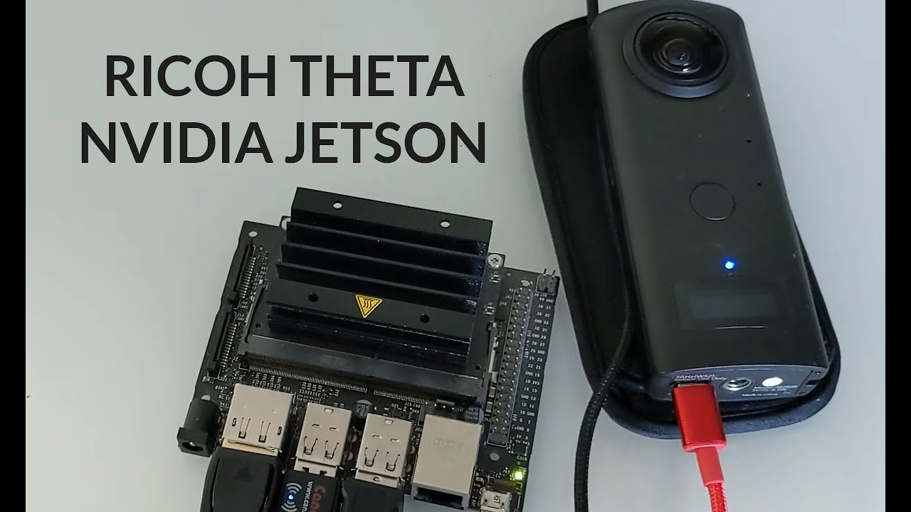

Setting Up NVIDIA Jetson Nano with RICOH THETA Z1 and X
Setting up an NVIDIA Jetson Nano for use with the RICOH THETA camera. We cover using the MTP API commands over a USB cable use gphoto2, live streaming 360 video with a modified version of libuvc, and light processing with OpenCV.
Although the USB API works fine, I’m having problems with streaming framerates, likely due to an insufficient power supply input. I used the 2A microUSB in the test. I’ve ordered a 4A barrel connector.
