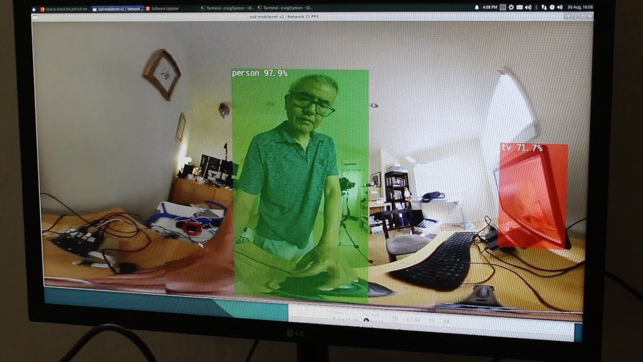

The newest test with RICOH THETA V firmware 3.70.1 is shown with a Jetson Nano in the video below.
Test was done with JetPack 4.4.
I intend to redo the test with JetPack 4.6.
DetectNet works.
The training images are not fisheye, so you will need to retrain the model with fisheye images to get a reasonable test.
