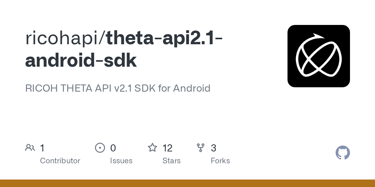

I tested the theta-api2.1-android-sdk and it works well with livePreview motionJPEG with the V.
Environment:
  • Google Pixel 3 emulator
  • Android 11
  • RICOH THETA V firmware 3.60.1
  • THETA V in AP mode
  • THETA V is indoors on a tripod with USB current supplied to the camera from a computer USB port using a data blocker
  • Sleep and auto-power off were disabled using the API
  • Tested for over 1 hour. No indication of any problem.
I suggest you test the SDK for Android above and run it on the tablet. It may help to identify if the problem is with the tablet or with your application.
