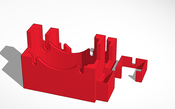

If the problem is heat, then people have used these techniques:
  • smaller and quieter fan on a tripod facing the camera
  • heatsinks from a Raspberry Pi
This is for the S, but you could fabricate a similar holder for the V.

Hi Craig, how long were you able to get before it overheat with that heatsink setup? How did you make those heatsinks fit so perfectly to the camera? I tried the fan and replacing the usb cable techniques, but I am still getting this error…
The heatsink pictures are from the community. I did not put the heatsinks on my camera.
