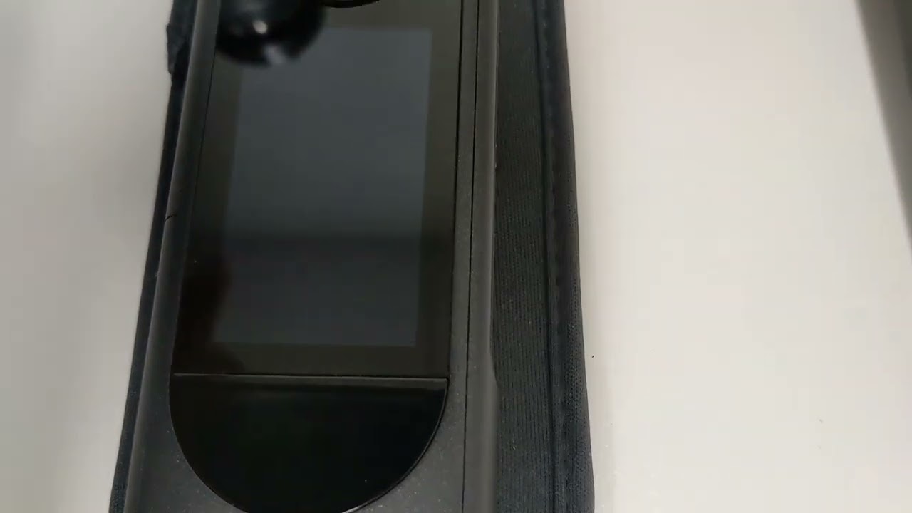

does switching off the lcd also turn off the compute driving the ui? I reckon the realtime rectilinear transform to generate the preview on the screen requires some compute as well
I also tried switching off the lcd via webapi, but when I proceed to trigger a capture using gphoto2 the ui get revived, with fancy animations and all.
I have been stress testing the thetax with captures back to back. with brightness set to lowest.
I can only capture(download and delete)(via gphoto2) a maximum of 100 times before the device thermal shutsdown(with plenty of charge). I have been able to do so up to 300 times on the SC2.
