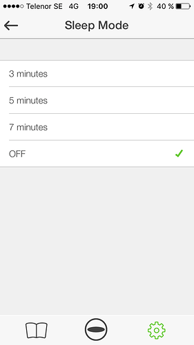

Automatically Turning Off the Camera Power When the Camera is Not in Use
If no operations are performed for a further 5 minutes after the camera enters the sleep mode, the power turns off (for example, if 3 minutes are set, the power turns off after 8 minutes).
The documentation is unclear. If I disable sleep, does it mean that the camera never turns off? I should try this.
I think there must be some difference between sleep and off. However, I do not know what it is.
