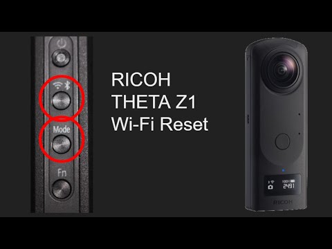

Sometimes the RICOH THETA camera will get stuck. This may happen during development. If there is a stuck plug-in running inside the camera or a WebAPI command causes the camera to become unresponsive, you should first try a shutdown. Normal Shutdown...
Est. reading time: 1 minute
Can you connect to the camera with the official RICOH THETA mobile app as a baseline test?
If so, you can see the Wi-Fi GHz in the camera settings.
With an API, it is this:
Notice of website closure
For the Z1, you can reset using the Wi-Fi and Mode buttons. See video above.

Hi @craig ,
I upgraded firmware
I’ve followed your guide to Force Shutdown, Wi-Fi Reset, Settings Reset using insomnia like this
but I still have this issue on iOS devices.
On Ricoh app it’s working well, and in settings I found 2.4 GHz
I noticed when I build my app to iOS devices it’s working but after several use, or next day I got 404 error.
