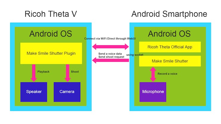

Architecture
This architecture is a useful solution if plug-in wants to use powerful features without cloud server.
For example: Recording high quality voice using Phone’s microphone; Optimizing Photo using Phone’s AI Chip;

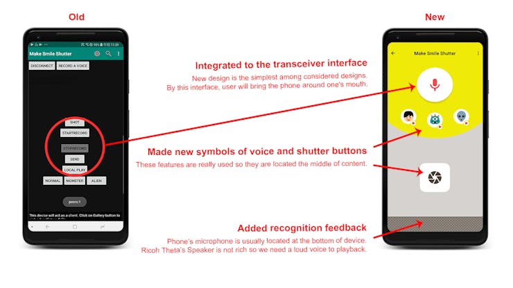

Design Consideration
Make Smile Shutter is a voice changer app so we considered suitable design.

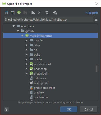

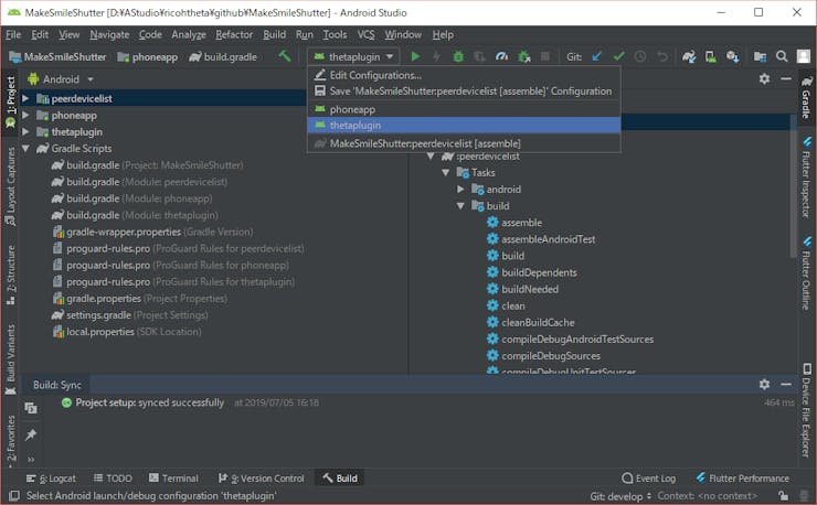

Getting Started
- Install Android™ Studio into your PC.
- Open makesmileshutter as a project into Android™ Studio.
- Please connect SMARTPHONE with USB.
Your smartphone needs to be a developer to debug through USB.
- Select “phoneapp” as a RUN TAEGET and build to install it into SMARTPHONE.
1 / 3
- Please connect RICOH THETA V with USB.
Register from here to enable developer mode.
Community’s article is also useful. *We really appreciate the developer community organizers as one of the Ricoh Theta Funs.
- Select “thetaplugin” as a RUN TAEGET and build to install it into RICOH THETA V.
