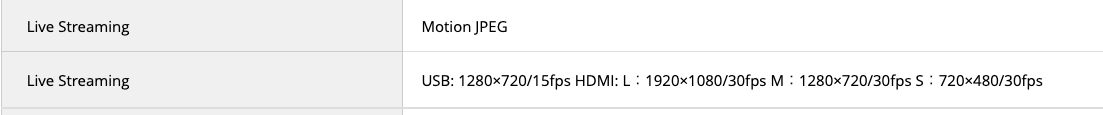

The THETA S streams motionjpeg, not UVC. You should be able to plug the THETA S in with a USB cable and get the camera detected as a motionjpeg video cam.
There may be problems with M1 Mac and motionjpeg web cams. Try search online for a generic workaround for M1 Mac and any type of mjpeg webcam.
