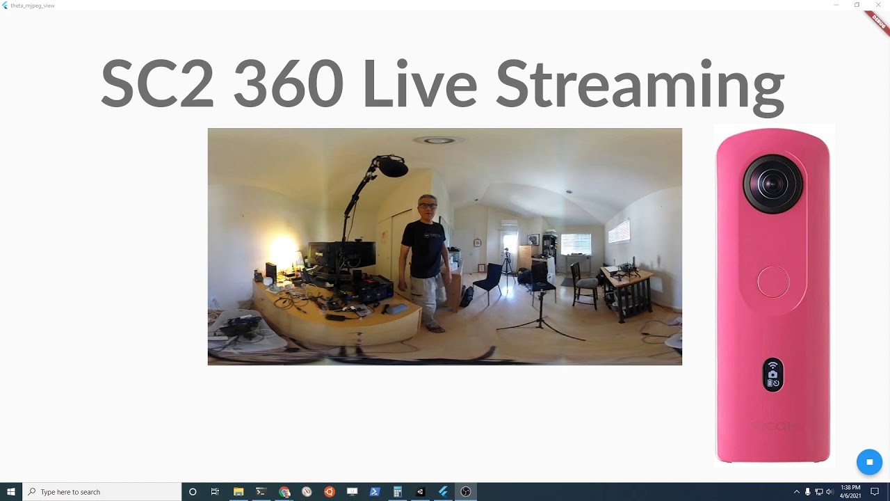

Example streaming from SC2 to Windows using same code

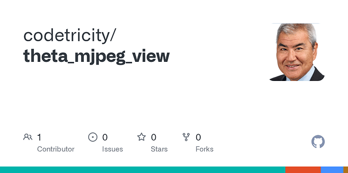

Example working with Flutter
It’s a bit old. I had intended to update and improve it, but I never got around to it. I recently tested it and it does work with the older version of Flutter and .Dart. From the commits, it looks like the last time I updated it was Aug, 2020.
