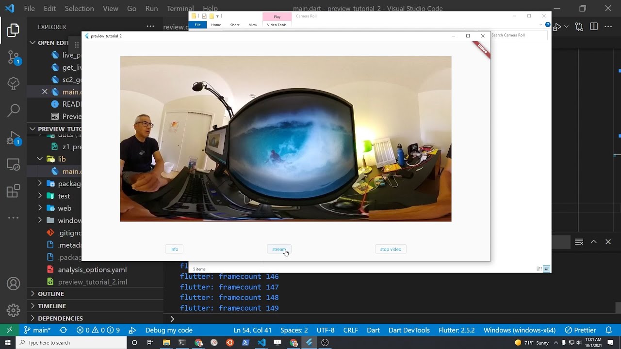

I’ve been using tpreview over the past week, both as a command line tester, where I find it to be super useful, and as part of a Flutter mobile app.
I used tpreview to test my V, Z1 and SC2 with displaying thumbnails. There’s clearly a difference among the three cameras. I will post a full video on Wednesday.
I am also working on building a Flutter mobile app. Compared to the command line tool, which I like, for seeing the camera in action - specifically seeing the livePreview - it’s just great.
Following the video that @craig posted here, I could add functionality buttons, and see the livePreview running in my app.
I’m working more with it this week. I’ll post some screenshots here.

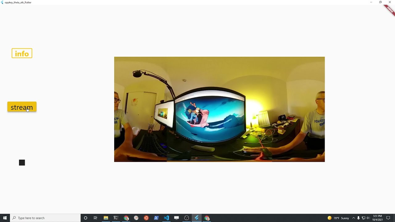

I extended the original tutorial demonstration of Oppkey THETA API Test Kit to show it running on a physical device Android phone in both landscape and portrait modes.
great to hear that you used tpreview (soon to be renamed opptheta) to test the live preview API settings. Perhaps like me, you were surprised by the differences between the RICOH THETA V/Z1 models and the SC2?
I extended the demo again to show how to move the buttons to the left of the screen.
3 button examples in landscape mode
