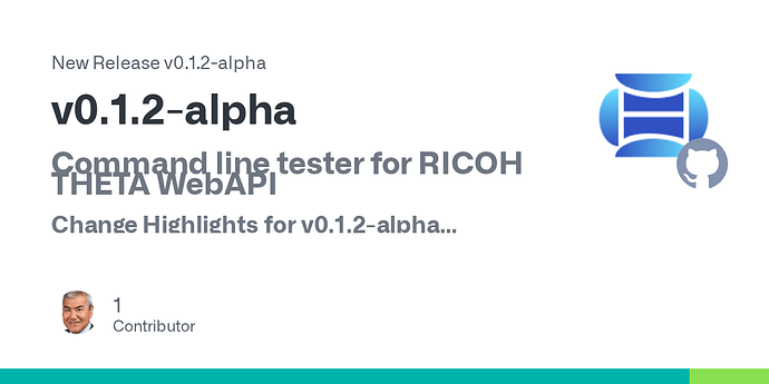

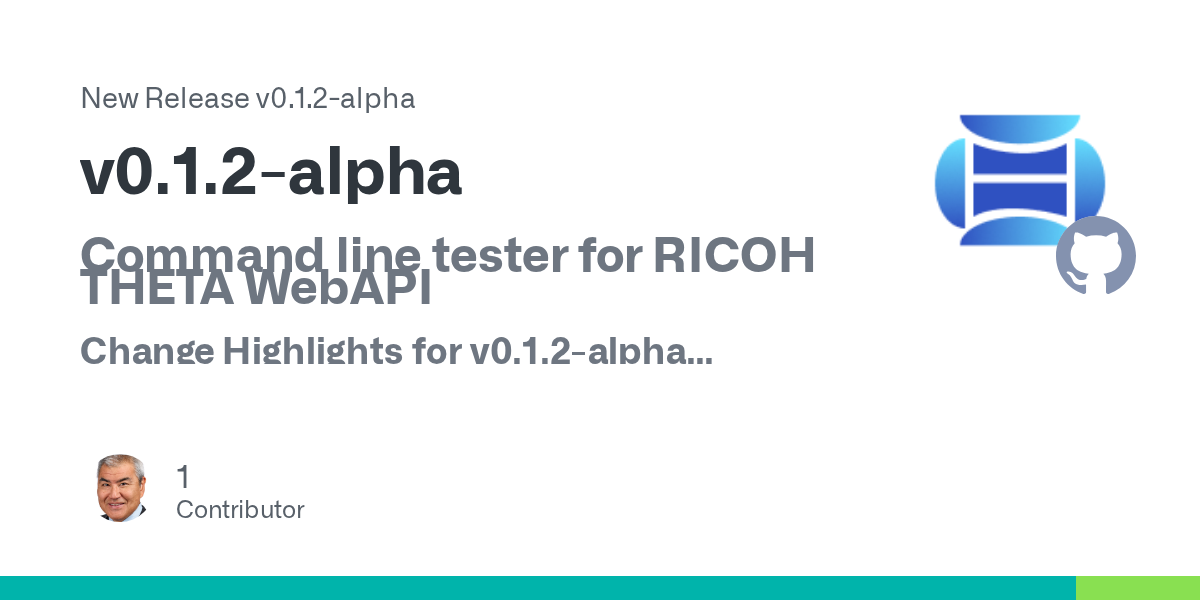

download theta testing tool
Get the tool we use for testing at this site:
Get the file raspberry_pi_theta.zip
transfer to Raspberry Pi and unzip
It is best to download it from a desktop Mac/Linux/Windows computer and then transfer it to the Raspberry Pi as the RPi browser is slow on my system.
Once the file is on the RPi, unzip the files.
go into script_examples directory
use text editor to modify the file take_and_upload
  • change the for loop to the number of pictures you want to take and upload example {1..500} will take 500 pictures and upload each picture
  • comment out sleep 10s and uncomment sleep 5m. A comment has a # mark in front of it
  • set up ssh keys on both the server you have the HTTP server on as well as your RPi
  • set up the HTTP server to grab the images from the appropriate directory you will scp to
  • change the server address to the address of your ip server
  • change the username and path to the credentials for your server
snippet of script - NOT the full script
