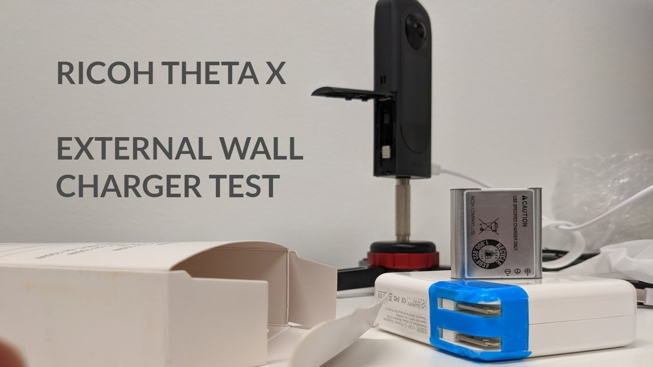

I have it running with Ethernet without the battery using passthrough power.
put an inline meter on it.
Note that the camera is consuming 9v in my test. I don’t work for RICOH and am not sure what the official specs are. However, you can run a test yourself and see how the camera behaves.

Thanks for your immediate reply. I have order a type-c current monitor and waiting for it come. When it arrive I will keep try it. Below table is experiment that I have test.
  1. Succeed - IPad Power
  2. Succeed - Raspberry Pi 5V/3A power
  3. Failed - typeC-USB cable and plus external power(5V/5A)
I will keep update if I have any new result.
