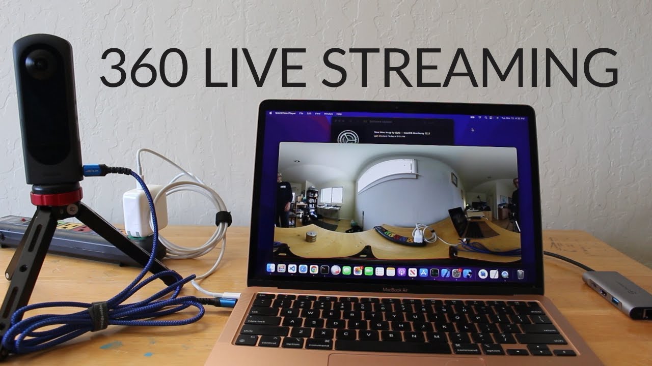

Update. I think it works with macOS 12.3
I tried it with the X after seeing the RICOH announcement yesterday. It worked. If there are further problems, please post again.
I tested with both Theta Z1 and X on macOS 12.3, both worked well
