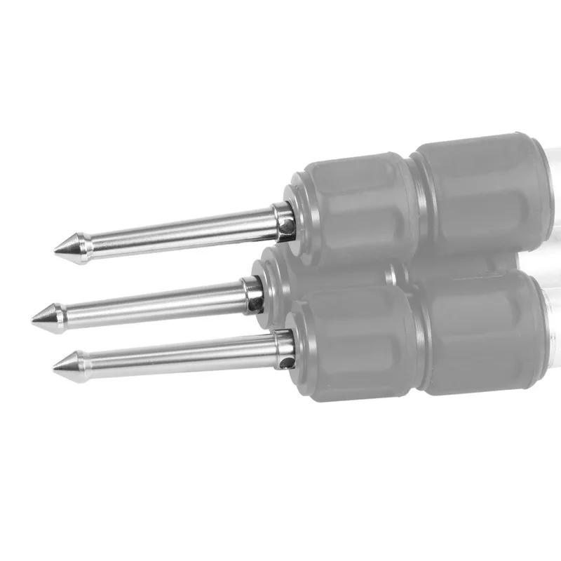

My 3 inch lawn spikes finally arrived!
Wow, that looks like a solid base.

Those look like great recommendations, and I would also be paranoid in high traffic situations like that. I’ve had a setup fall over only once, and luckily it landed in the grass mere inches from a cement curb. My stomach sank as I watched it fall in slow motion from my hiding spot, and it prompted me to purchase a second Z1 as a backup, along with the lawn spikes I show earlier in this thread.

I was wondering if you could share the links to your rotating base as well as the spikes that you added on, I haven’t had much luck finding the spikes on amazon.ca

You won’t find either item on Amazon.ca, which being a Canadian was disappointing.
The rotating base is from this item on Amazon.com
The spikes took me quite a while to find. Managed to find them on AliExpress.
Hope that helps :slightly_smiling_face:
