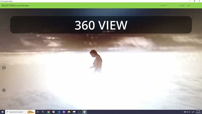

To test the live preview of the RICOH THETA X, I had previously built a Flutter application that runs on desktop and mobile. After receiving a few questions about the project, I tested it with the Z1 and also enabled 360 view.

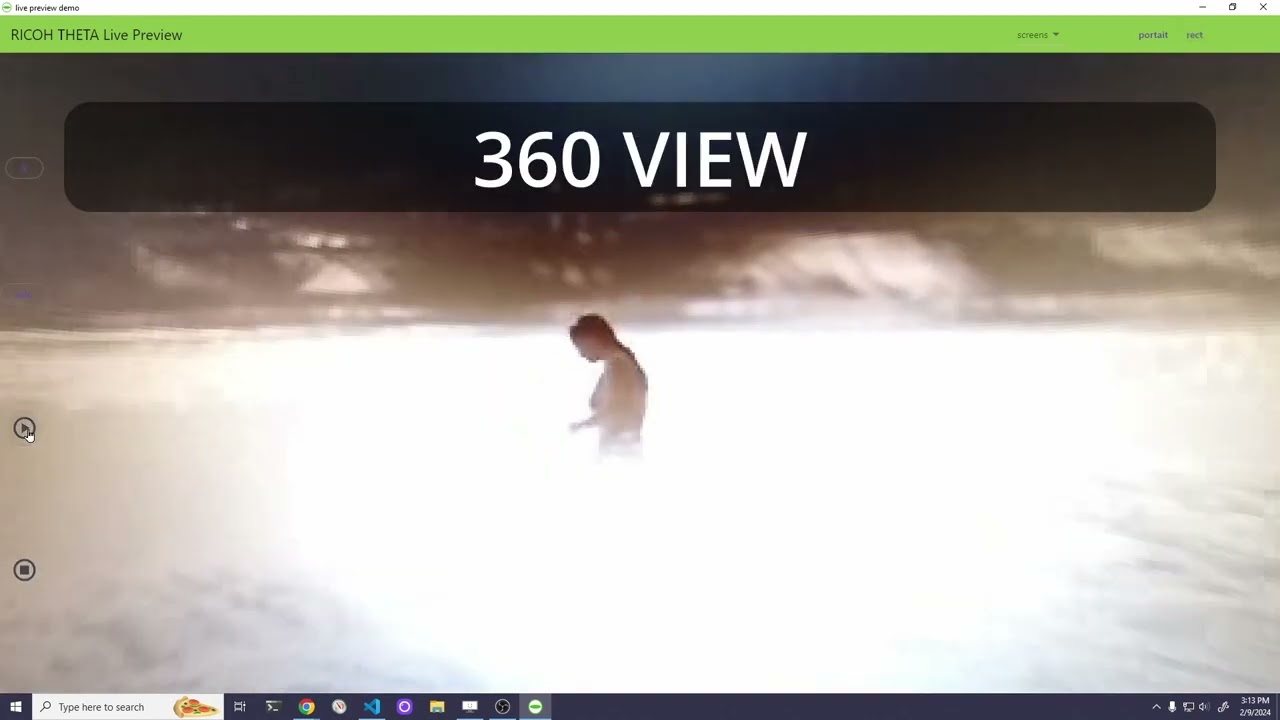

In the upper right of the application, there is now a button to switch between equirectangular and 360 view. To test the motion, I place my camera in front of YouTube video.
Below is an equirectangular view.
implementing 360 (panorama) view
