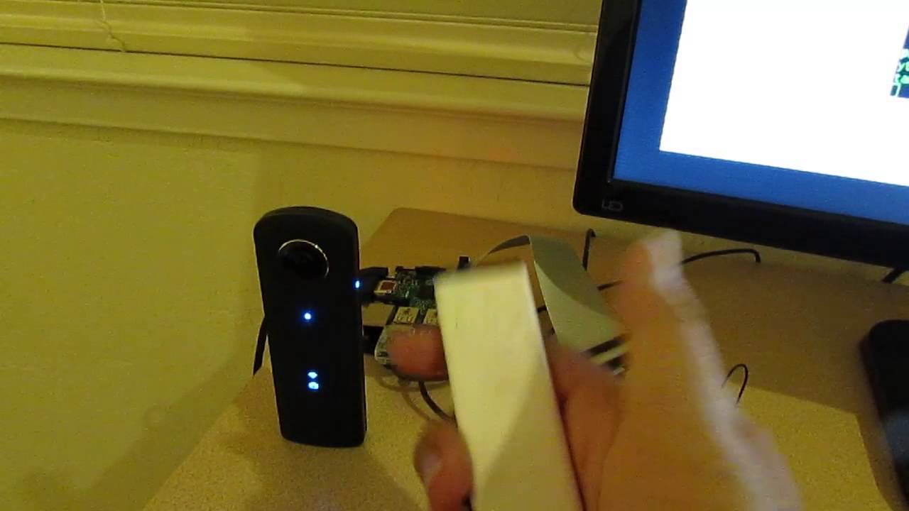

here’s a video we created for a demo to show the THETA taking a picture from a Raspberry Pi using the GPIO pins. The idea was to show the GPIO pins of the RPi in use and then give people the inspiration to connect something like a motion sensor to the Pi.
You could also set it to start at a certain time or after a certain time interval. @jcasman was working on this and he may have finished it.
