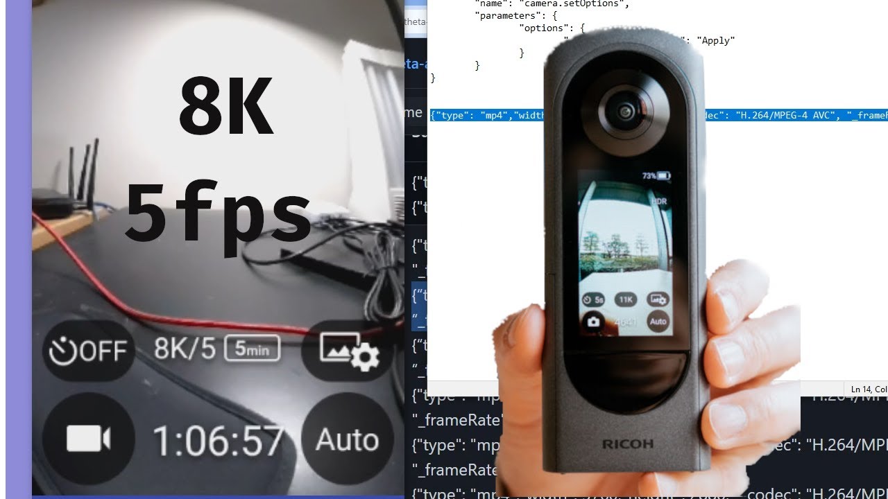

Using the free API Tester tool to set 8K 5fps video on the RICOH THETA X for Google Street View.
file format API for 8K 5fps: theta-api-specs/theta-web-api-v2.1/options/file_format.md at main · ricohapi/theta-api-specs · GitHub
API Tester: https://play.google.com/store/apps/details?id=apitester.org&pcampaignid=web_share
POST command, not GET
Body is Raw
Content Type is application/json (which should be automatically filled in)
Post Data
Usage to set 8K 5fps
  1. connect mobile phone to X in Access Point (AP mode)
  2. Press play on the mobile app
  3. verify that the video mode switches to 8K 5fps on the screen of the camera
to start video
You must press the button on the body of the camera. If you need to get out of the picture, you can use timer delay.

The camera request will fail with an error if any FPS is sent other than 5, 2, 10.
Triggering the 8K 5fps or any 8K video from a mobile app is disabled in the API. It might be due to heat.
It may be possible to write a plugin with an internal web server to talk to a mobile app and then start/stop the 8K video.
As a short-term workaround, can you use a Bluetooth remote as the trigger for the camera on top of your car or head?

I added 8K 5fps to the app below. It’s now a button.
@jcasman can you test the app above for the 8K 5fps settings?
I certainly will. Thank you, but it won’t be for a few days as currently in the middle of rebuilding my external GNSS hardware solution.
Hi, I just finishing testing it. It works well.
Download the app using the URL. Click through accepting the download (several popup screens).
The app is running.
Make sure you’re connect by Wi-Fi to the THETA.
In the X section (click the X icon on the bottom right of the main screen), it shows the option to set to video mode and then set to 8K 5fps. If you’re not in video mode, it won’t work. You can also set video mode using the physical mode button on the side of the camera.
Video appears to me to be at 5fps, due to the (expected) jerkiness.
Bonus: You probably don’t need it, but if you want to use the app to move back and forth between image and video mode, if you go into the Settings section (click the setting gear icon on the bottom left of the main screen) you can see image and video there.
Finally, you can also switch between image and video using the touchscreen LCD on the front of the THETA.
