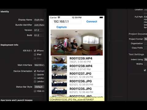

I’ve successfully tested it with the Z1 and X in addition to the V. I can’t remember if I tested the iOS with the X, but I have not heard of problems.
Z1 with android
Z1 with iOS
