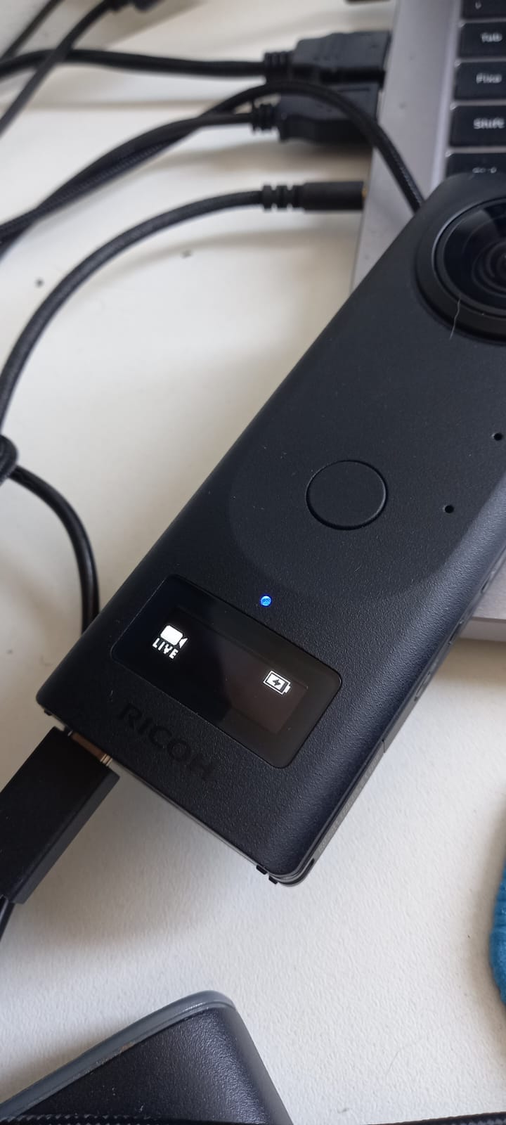

Furthermore, my intention is to pass the camera’s path when creating a Docker container with Ubuntu 20.04, so i can access the camera in it, so then i can use an integration with ROS Noetic. However, i’ve read some tutorials to set up the environment for the camera on Ubuntu, such as the one in https://community.theta360.guide/t/linux-getting-started/10945, but when i try to run gst_viewer, it has returned that the theta camera was found, but cannot be opened. The camera is connected and on live mode:

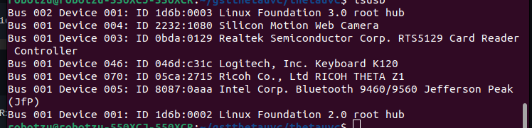

When i try to type lsusb, i get the following results:
In a previous topic, i’ve read that it should’nt return 2715, but 2712, as it is recognized as an storage device.

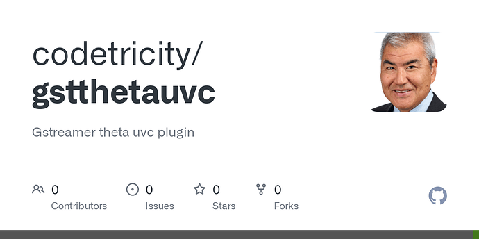

I’m not sure if i missed some step, or the error is caused by some kind of incompatibility with Ubuntu 22.04. I also tried to install the Gstreamer theta UVC Plugin
I reassured that it was correctly installed, but i get the same error that theta was found, but cannot be opened.
