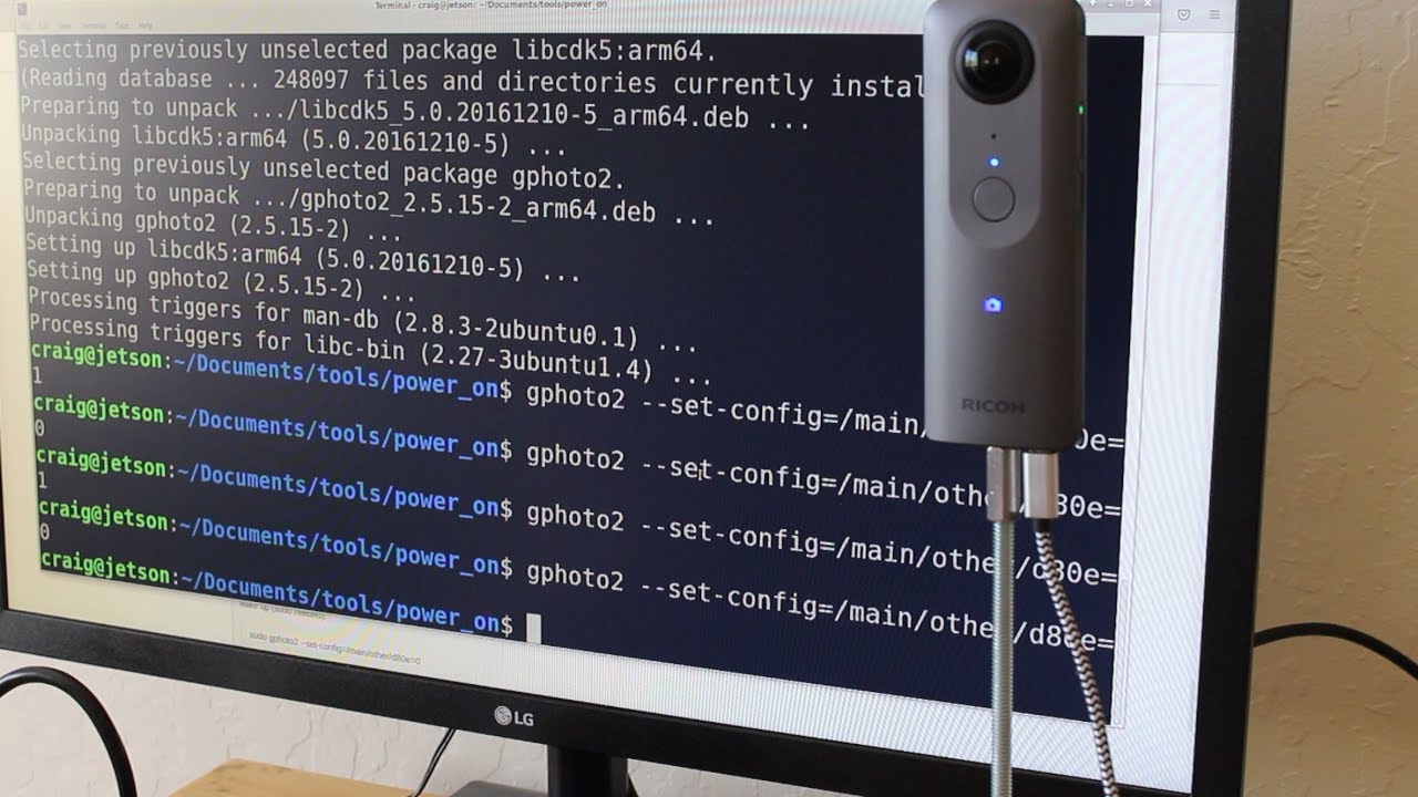

You can use the USB API to:
  • put camera to sleep (which will stop the stream)
  • wake camera from sleep, which will restart the stream
Alternately, you can use the USB API to switch the camera to video or image mode, which will step the stream over the USB cable.
FPS should be in the 30fps range with a 4GB model of the Jetson Nano without opencv processing. It will drop if you’re using object detection.
I tried all of those command that you have mentioned but it is giving an error device is busy and this is only happening when I am trying to stream more than 15-20 minutes.
Running on Jetson Nano with libgphoto2

even on trying with libgphoto2 getting same error please see
gphoto2 --set-config=/main/other/d80e=1
*** Error ***
The property 'PTP Property 0xd80e' / 0xd80e was not set (0x2019: PTP Device Busy).
