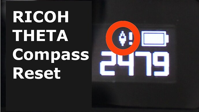

Pose heading degrees is not being captured on Ricoh X. It captures GPS coordinates, pitch, roll, etc. But we do not see pose heading on our images captured with the Theta X. We shot our images without connecting to the app and only using the camera with wifi and GPS turned on.
This is the expected metadata from the RICOH THETA X using the internal compass and gyroscope. No mobile app, just the camera. PosePitchDegrees and PoseRollDegrees are zeroed out due to auto-level (topBottomCorrection).
This data will not appear if the camera needs compass callibration.
Follow these steps
  1. upgrade to the newest firmware of the camera
  2. review this article for compass callibration
Your camera is running firmware 1.20
The newest firmware for the X is 2.51.0, released 2024.06.04.
Likely, your internal compass needs to callibrated with the figure 8 movement in the video.
Please post again if you have any problems.

In the state command, there is an error code for ELECTRONIC_COMPASS_CALIBRATION and the screen on the body of the camera does show a warning icon. However, it’s not obvious that PoseHeadingDegrees write failed.
@TillerXR were you able to get the PoseHeadingDegrees? Or, are you still having problems?
  1. upgrade camera to latest firmware (newest version shows error icon if compass needs calibration)
  2. calibrate compass with figure 8 motion (if needed)
If the compass needs to be calibrated, the PoseHeadingDegrees will not appear in the JPEG metadata.
In newer firmware, you will see this when the camera needs to be calibrated.
