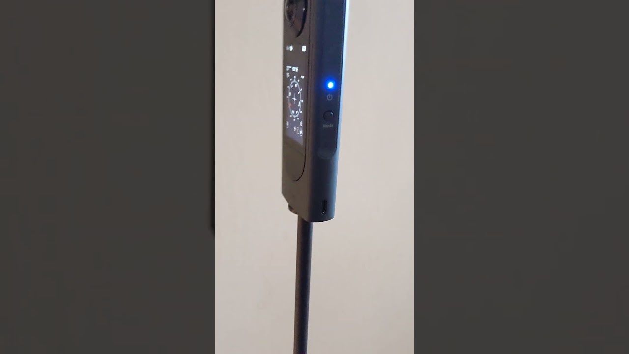

I recently had problems extracting GPSImgDirection from THETA X image metadata. This information is used for auto-placement orientation of images on maps.
After many attempts, a friend told me that I needed to reset the internal X compass. On my unit, the compass had become disoriented due to exposure to a magnetic field. These fields are common around office equipment.
I used the motion in this video.
The figure 8 motion was the same for the Z1 and the X in my experience.
The X did not show an error on the LCD. It was a bit tricky for me to figure out the compass needed to be reset.
I used THETA X firmware 2.21.0
