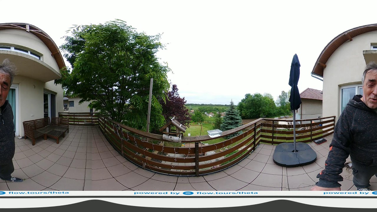

Hi, @Juantonto ,
I just tested today and also compared to my HDR Wireless Live Streaming plugin that is available in the Ricoh Plugin Store, second half of the stream is done with my plugin first half with Ricohs
