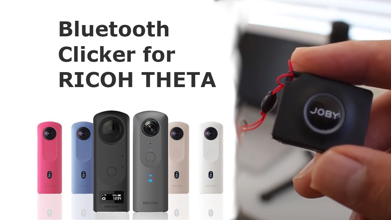

How To Use RICOH THETA With Bluetooth Clickers
New video shows how to set up a RICOH THETA Z1 a JOBY Impulse Bluetooth clicker.
Current firmware for the Z1, V, SC2, and SC2B have the plug-in in the firmware.
For SC2 and SC2B, press and hold the timer button to pair the clicker.
remote_blink
Press and hold again to turn off.
Press and HOLD the JOBY clicker to start the pairing.
JOBY
Once paired, the bluetooth icon on the camera will be solid and will not blink.
For the Z1 and V, you should watch the short video above. The process is the same, but use the mode button instead and select the remote plug-in.
