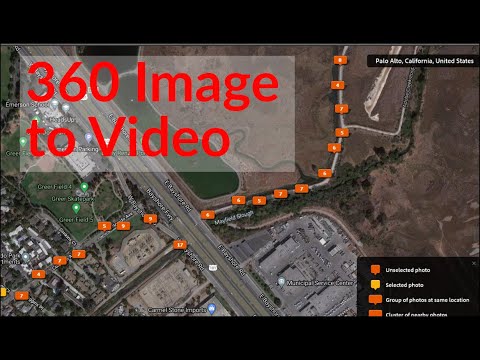

I’m going to go forward with a test with
  • Z1,
  • firmware 2.00.1
  • Android app 2.1.0 on Pixel 2
  • bluetooth and mobile data disabled on mobile phone
  • 2.4GHz Wi-Fi
  • auto connection disabled to force checking if camera loses connection to Z1
  • location enabled
  • postview disabled (no transfer for images from camera to mobile phone)
Results
GPS data for 151 pictures looks accurate for most of the shots. There are zero pictures that show GPS off by several kilometers. break in the picture coordinates are due to a tunnel under the highway.
Scenes have good access to sky in California.
Other Test Conditions
  • air temperature is 93F
  • I have the Z1 mounted on a monopod. I used it like a selfie stick and kept walking at the entire time without stopping
  • In my other hand, I held the Pixel 2 and pressed the shutter button on the mobile app
  • I did not transfer the pictures to the mobile phone
  • I did not lose Wi-Fi connection during the test
Shadow in the test gives you an idea of how the pictures were taken.
accuracy looks quite good for all pictures. The works on the map and the rocks in my shot match.

I put the 151 images into a 360° video sequence. You can see the position of my hand with relation to the Pixel 2 I am holding as well as the surrounding area.
The test is mostly free from GPS signal blockage and Wi-Fi interference. However, I did go through a tunnel at one point.
