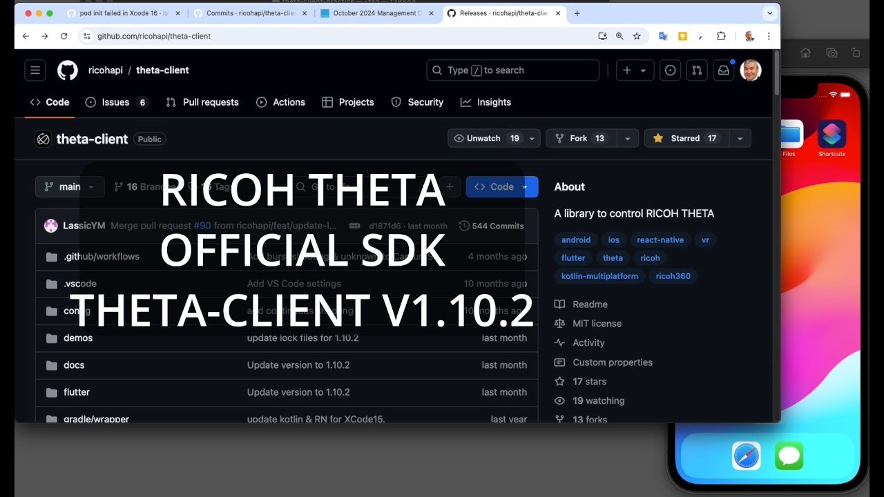

How to build the theta-client 1.10.2 for iOS 17 using Xcode 16. This demo uses cocoapods and a Podfile.
RICOH THETA theta-client Open Source SDK
https://github.com/ricohapi/theta-client
iOS demo for theta-client
https://github.com/ricohapi/theta-client/tree/main/demos/demo-ios
