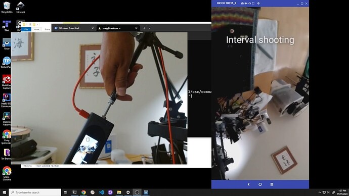

OK. I’ll extract the frames and see if I can replicate the behavior. It looks like the frames are corrected in the video, but I do not remember if I saved to local storage and checked.
Unfortunately, the Z1 and SC2 do not support topBottomCorrection of the preview frames in motionjpeg. Only the THETA X does this. In the video I posted, I only tested the X and I incorrectly assumed that the other THETA models would handle topBottomCorrection of the preview frames.
