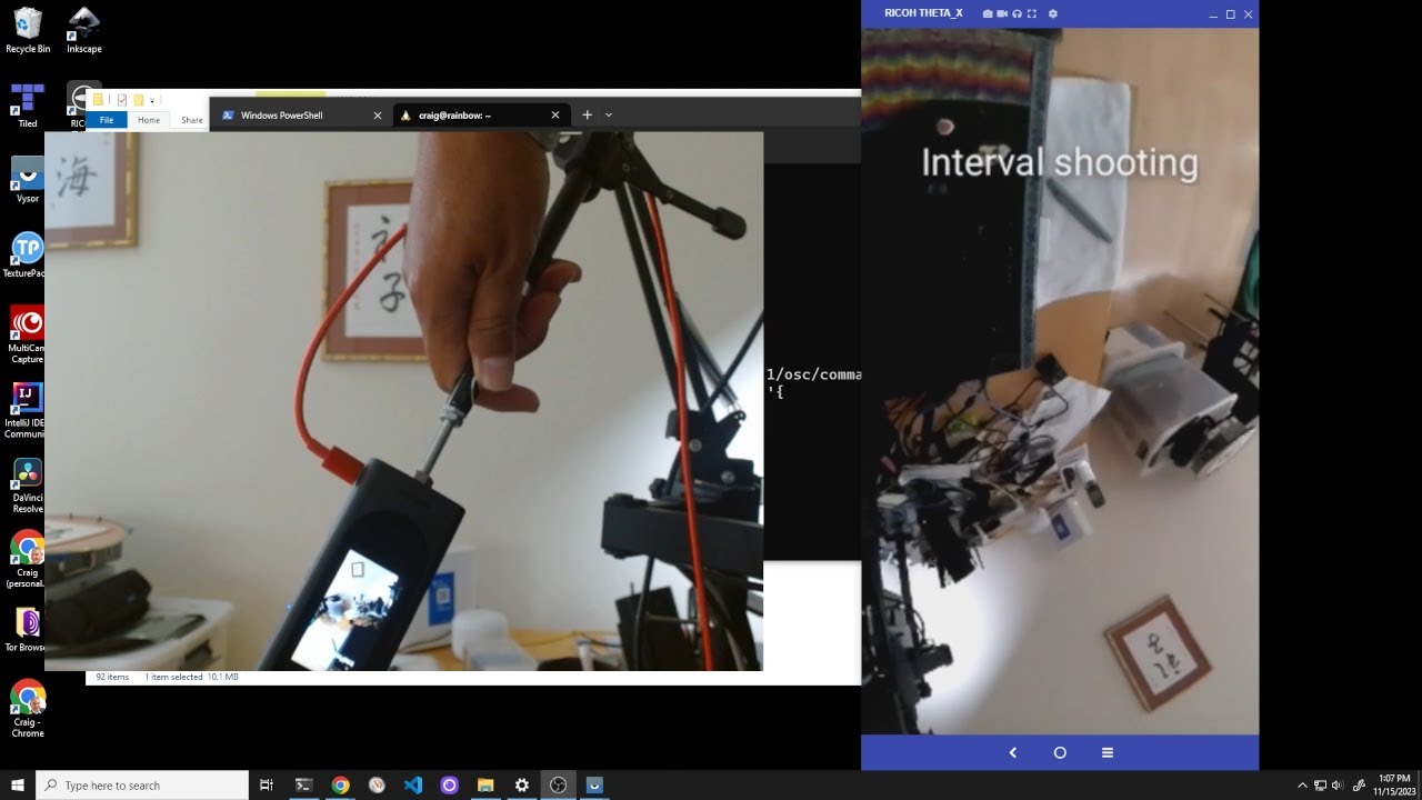

Images
with camera on side
Shown on body of camera.
Viewed in equirectangular mode
Note that the RICOH desktop app will automatically reorient the image

  • the official RICOH mobile app sets the _topBottomCorrection to Apply in my tests
  • to test _topBottomCorrection set to Disapply, I used a free mobile app
  • to test interval shooting, I used startCapture to start the shooting sequence and stopCapture to stop the sequence
  • I set_topBottomCorrection to Disapply prior to every interval shoot
