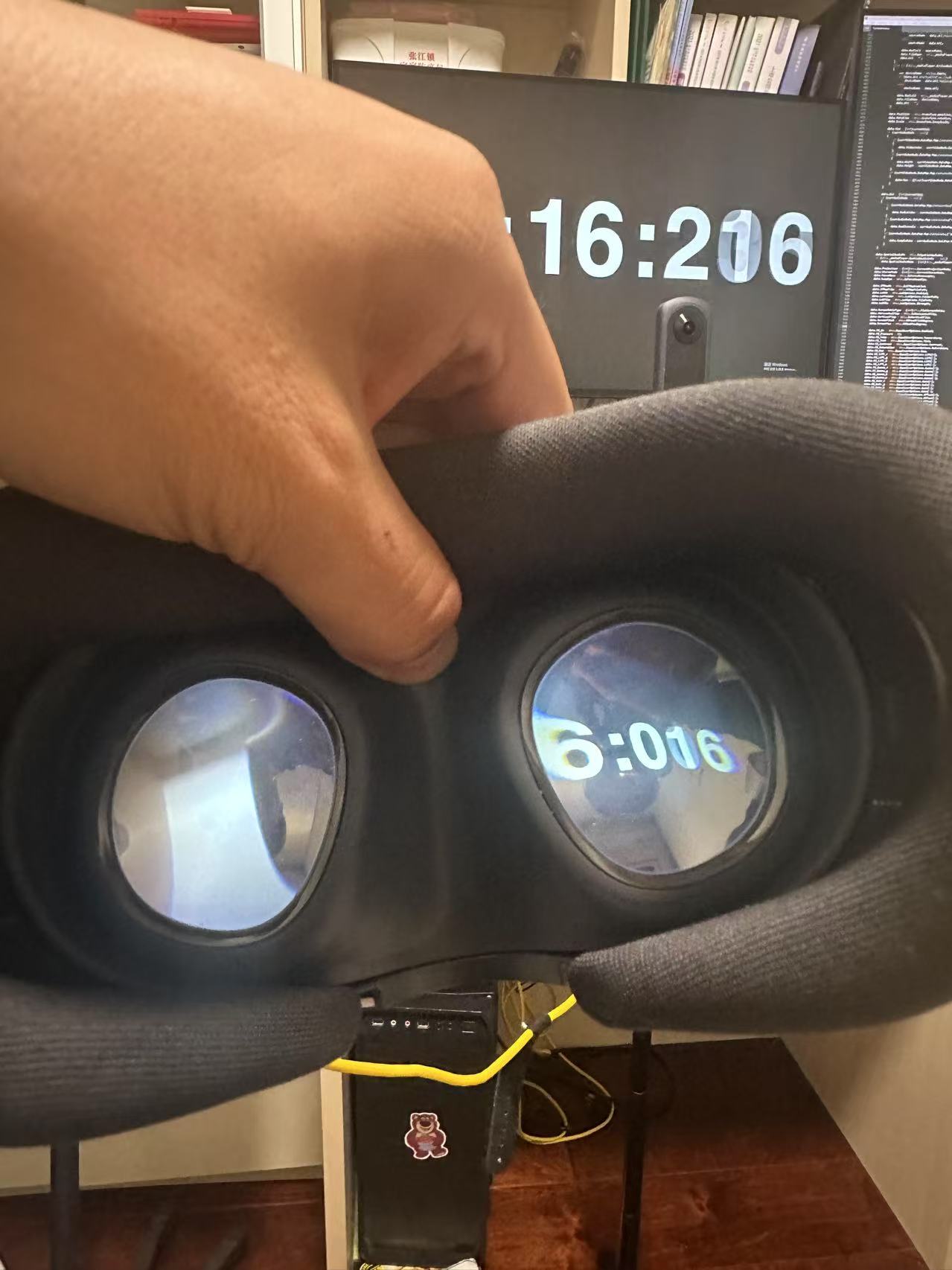

For 1920x960@30fps, the screen-to-screen latency I measured was 200ms. There are two parts that contribute the most to latency: H264 encoding/decoding and stitching. If we use NDI, perhaps neither of these two parts is needed.
That’s great. How is the camera connected tot he headset? With Ethernet?
I use USB cable connect THETA to headset
