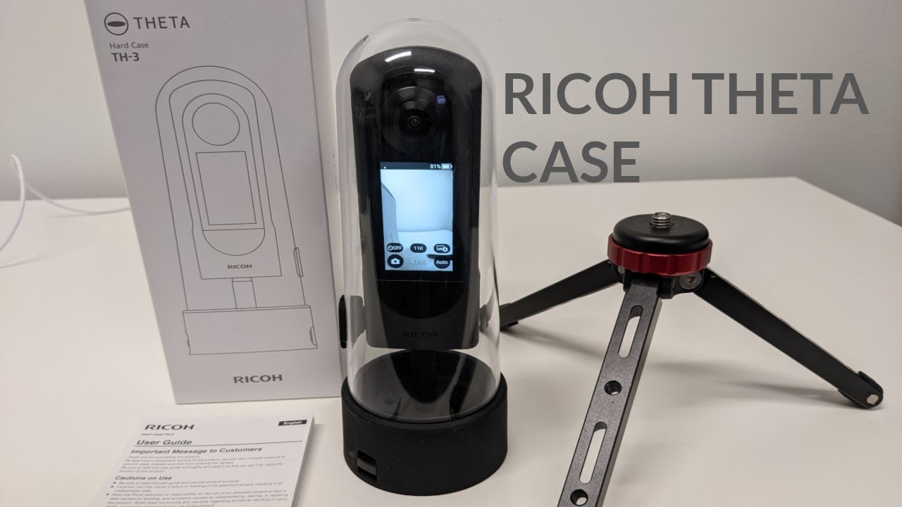

Review of the official RICOH TH-3 case with the RICOH THETA X.
- water-resistant, not waterproof
- good image quality in uniform light. significantly decreased from camera not in case, but may be good-enough for many applications
- links to original images from camera available for download and inspection
- USB cable can power the camera while the camera is in the caseyou

Case Usage
The connection is NOT waterproof. Water will likely get into the case if submerged. Should be OK for rain. I did not test in the rain.
Action shot. Extender is not needed. You can put it directly on the monopod.
used car interior test
