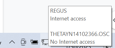

To get started on using the Camera’s API, it’s best to have two separate network connections on your computer, one connection for your internet usage and browsing, and another connection for the Camera’s wifi network. On the laptop I’m using, I have an Ethernet connection on one network for my internet browsing. I am also using the laptop’s own Wifi to connect to another network which is the RICOH THETA Camera’s network.
In both Screenshots we are connected to REGUS for internet access and THETAYN… to connect to the camera via wifi.

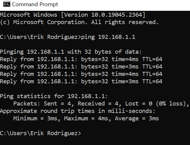

For a quick check to see if you can connect to the camera you can open up your command line and ping the camera at 192.168.1.1
Screenshot above shows a successful connection

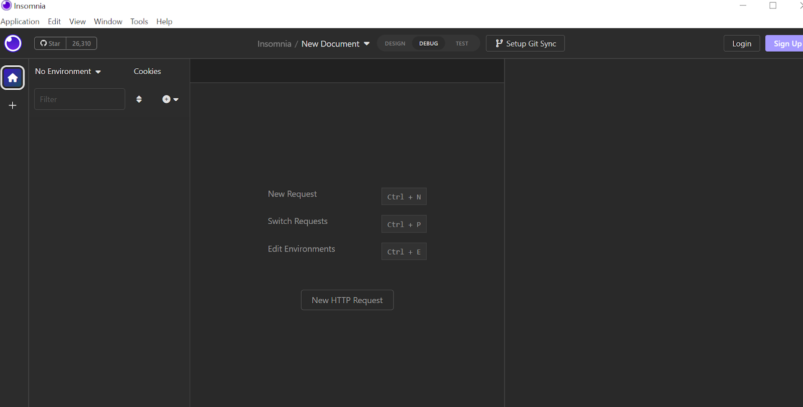

Above is an empty environment so you want to make a new request by pressing Ctrl+N

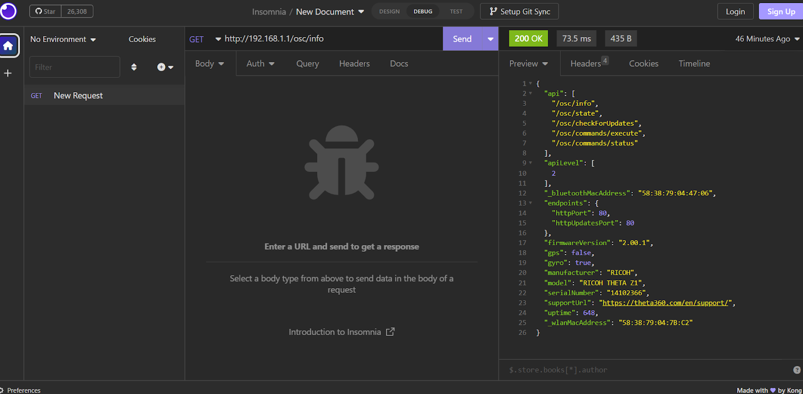

Now Insert http://192.168.1.1/osc/info at the Top and press Send. This is the GET command /osc/info from the RICOH THETA API and the base of the API Command is http://192.168.1.1 for all RICOH THETA cameras.
you should get a response to the right with useful information such as the serialNumber and model.

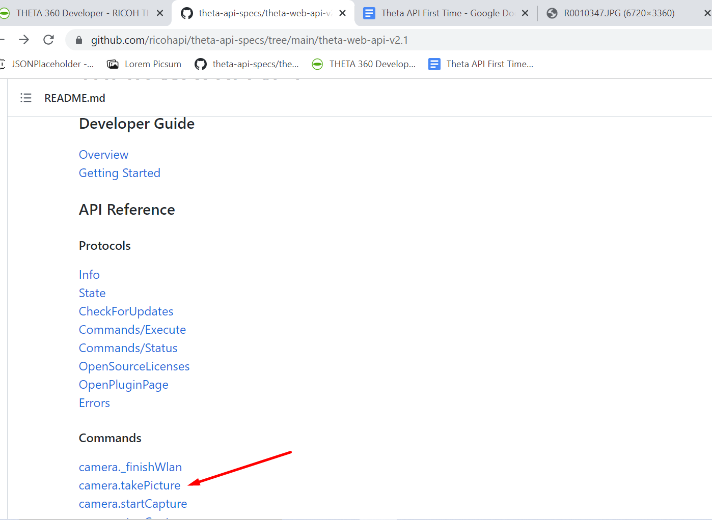

We are going to use the POST execute command from https://github.com/ricohapi/theta-api-specs/blob/main/theta-web-api-v2.1/protocols/commands_execute.md
Here are the steps:
  1. Create a new Request
  2. Rename it to something like “Take Pic”
  3. Change the Request type to POST
  4. Enter the API command http://192.168.1.1/osc/commands/execute
  5. Change the Body type to JSON
  1. Inside the JSON body type in the required “name” of the command to execute which for this example is camera.takePicture taken from the API command list as shown in the first screenshot above
  2. Send the Command and your camera will take a picture!
