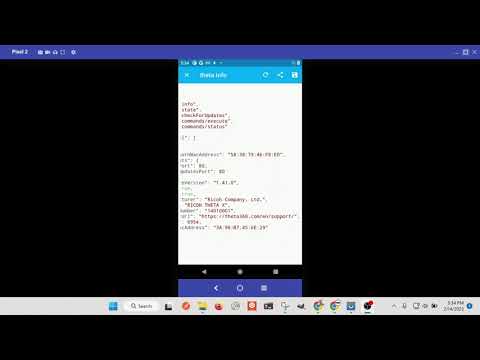

In this demonstration I’m testing the API with a mobile android app, as shown in the article referenced below. Currently, I have tests showing different RICOH THETA API commands and requests. I intend to do more tests in the future such as Exposure compensation.

/osc/info ![]()
/osc/state ![]()
