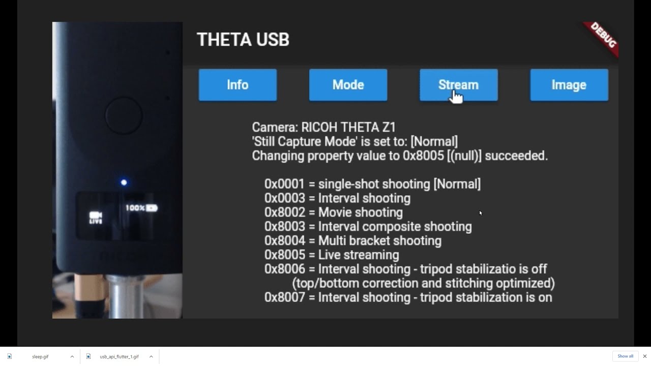

I’ve started the build a test GUI using Dart with Flutter widgets and GTK on Linux. At the moment, I can just change between still image and live streaming with the buttons. I have many of the other commands built out, just not connected to buttons. At the moment, I’m using ptpcam behind the buttons. This makes it easier to manage the scripts I am building to test more of the camera USB API.

Test with Two Cameras in Streaming
$ ptpcam --dev=041 --set-property=0x5013 --val=0x8005
Camera: RICOH THETA V (bus 0, dev 41)
'Still Capture Mode' is set to: [Normal]
Changing property value to 0x8005 [(null)] succeeded.
craig@cube:~$
$ ptpcam --dev=042 --set-property=0x5013 --val=0x8005
Camera: RICOH THETA Z1 (bus 0, dev 42)
At this stage, I now have two cameras streaming into the same devices. I need to do more tests to manipulate both streams.

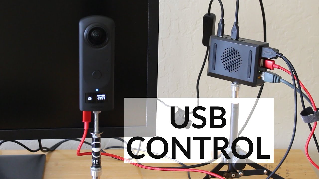

  • Walkthrough of compiling libptp and ptpcam on Raspian 10 buster using Raspberry Pi 3
  • Example uses libusb-compat with links to relevant GitHub repos our SourceForge downloads
  • Overview of options to use THETA USB API from the camera, including using subprocess or process from different languages such as Python and Dart. The example above uses Dart and Flutter on a Raspberry Pi 3 to send API commands to a THETA Z1 using the USB cable.
  • Added new section on using Raspberry Pi to turn on THETA from power off state. Previous technique only explained how to use an NVIDIA Jetson to turn on THETA. You can likely use an x86 computer, but it is more expensive.

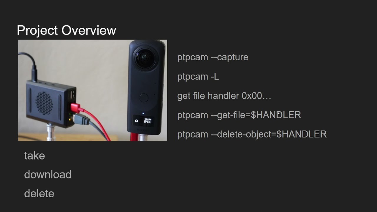

RICOH THETA Raspberry Pi - Take, Download, Delete Files with USB Cable

This is an example putting the camera to sleep and waking it up as well as powering it on and powering it off. Older firmware, but the API still worked with the Z1 in my more recent test with firmware 2.00.1
This is very cool. What type of board do you have connected to the RICOH THETA? Is it a Raspberry Pi, Jetson Nano, x86? The libptp code is a bit difficult to work with, so this type of project is a big help to add an easier layer of abstraction.
The controller is amazing. Well done! I’m curious as to what the board you are using is so that I can test it out with similar hardware. Maybe I should try it on x86?
