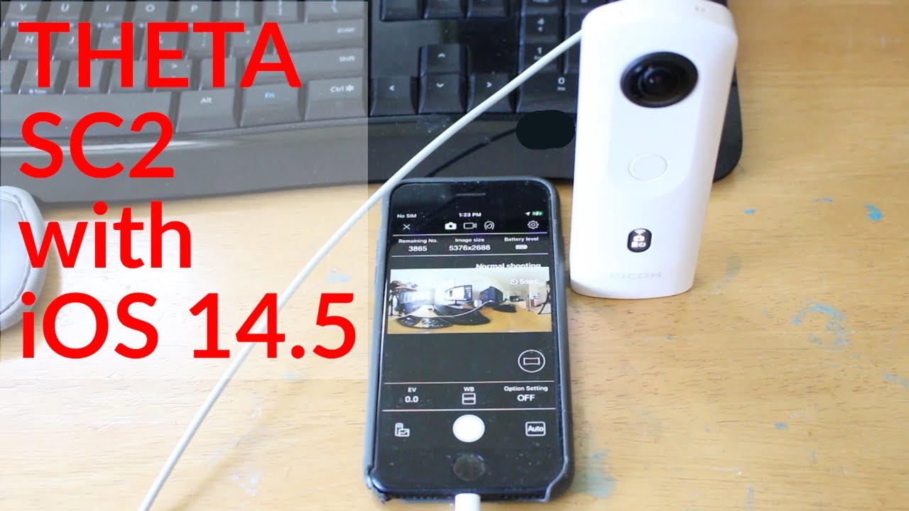

I tested the firmware upgrade on an SC2 and can connect to iOS 14.5 with SC2 firmware 1.61 beta.
See the video below for a step-by-step process.
