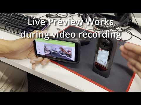

The preview works fine during video recording.

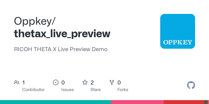

Code used in demo is here:
running as windows desktop and simultaneously recording video
