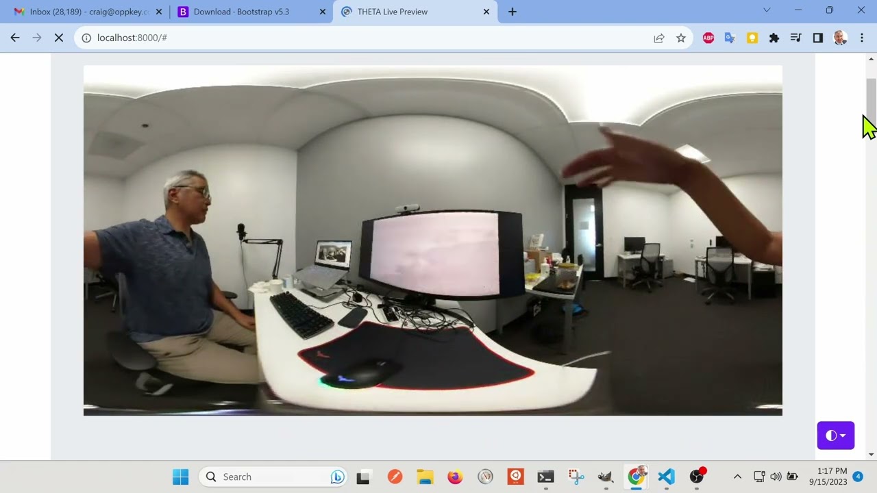

You can stream a live preview from the THETA X direct to a web browser.
How To
connect laptop or mobile phone to camera with WiFi
if in access point mode, go to http://192.168.1.1/getLivePreview
example using Google Chrome browser
Alternative technique with live preview embedded in web page
snippet using bootstrap
<div class="col-lg-12 px-0">
<iframe src ="http://192.168.1.1/getLivePreview" width="100%" height="600">
</iframe>
</div>
Latency
310ms
362ms
188ms
