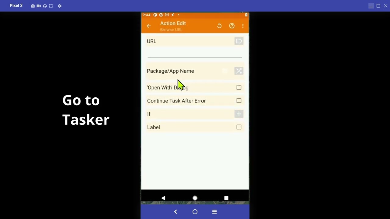

In the Tasker app:
  1. Enter the Tasker App and Go to the “Tasks” tab and add a new Task and name it something like “Info and State”
  1. In the Info and State Task add a new event
  1. In the bottom area of the popup where it says “Filter” type in “Browse” and the “Browse URL” option will show, press on that option.
  1. Paste the Deep-Linking URL that we copied earlier into the URL section. Optionally you can add a Label which you can think of as naming the Action and it does make it easier to view which actions or events are currently running.
Press the Back arrow once done and now we’ve successfully added our first Task to the list!
Repeat steps 1-7 above to add more API commands to this one list.
