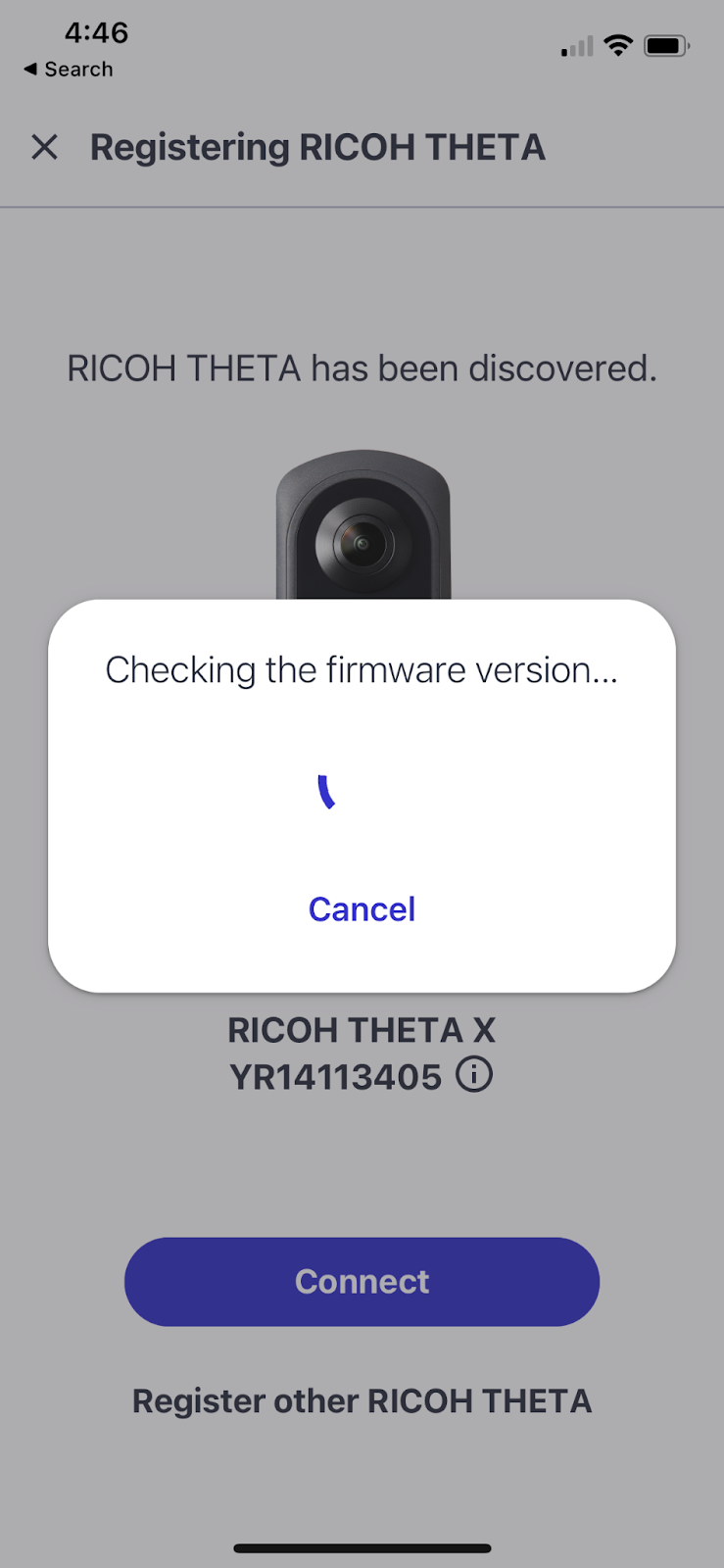

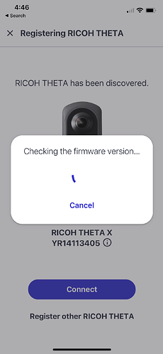

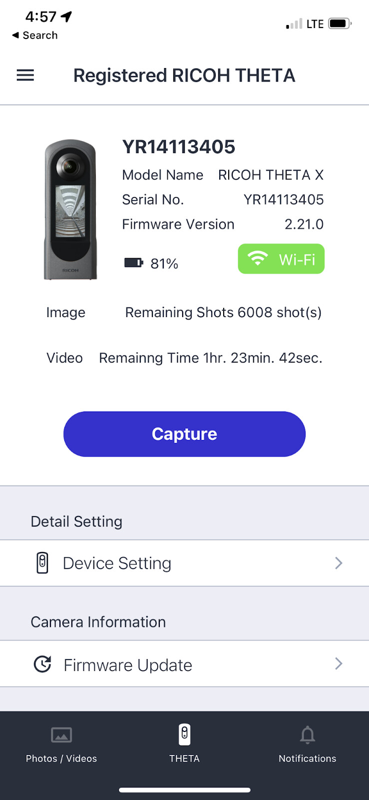

  • Finds X, checks firmware version
    • Firmware update possible through app, appears to be the same sequence at the official RICOH THETA app (mobile update)

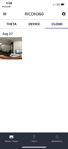

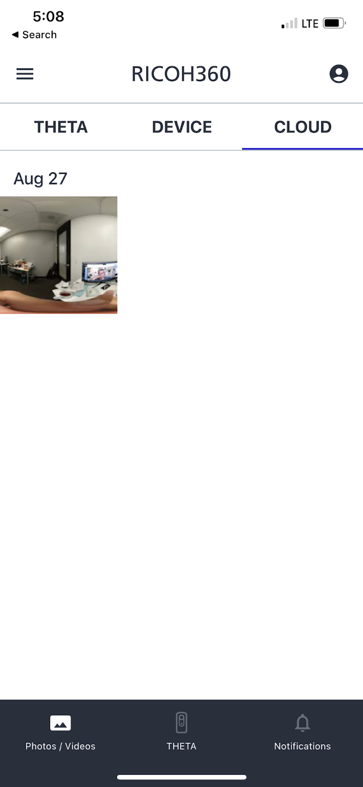

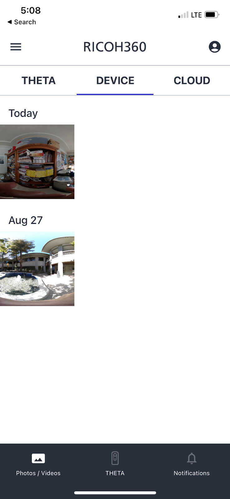

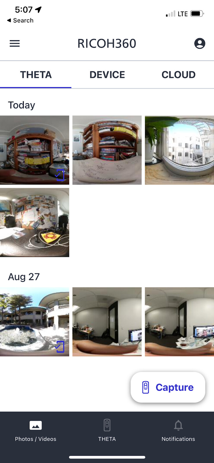

Note: The announcement indicates that “functions that use Ricoh’s image processing technology, such as AI image correction and AI human blurring, are also available for effective use of 360-degree images.” I tested the AI human blurring. It found not only me, but a face from a video conference on a nearby screen and nicely blurred both. Example here:

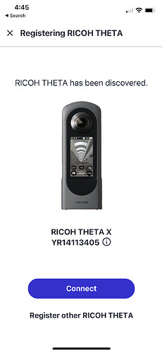

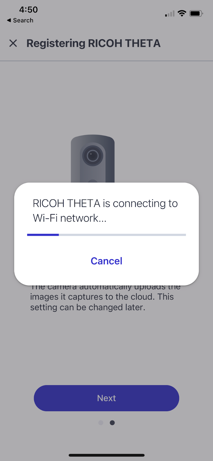

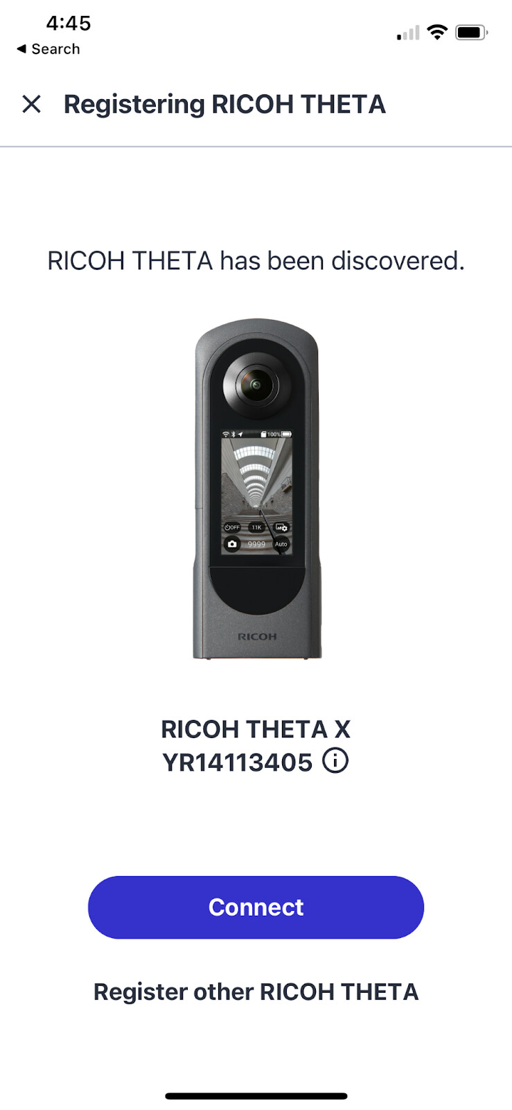

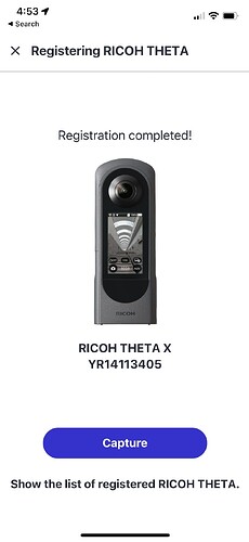

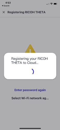

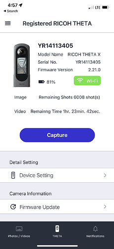

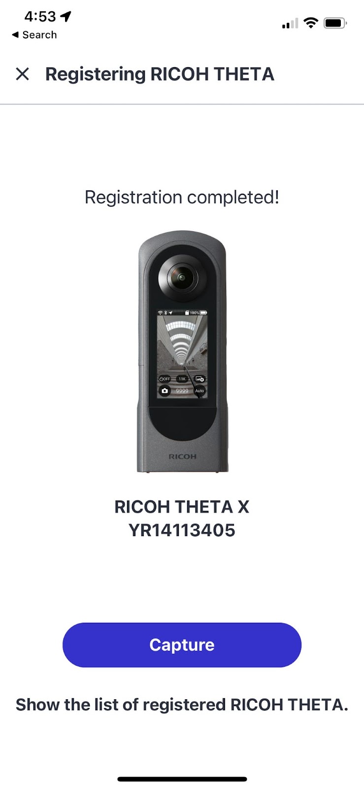

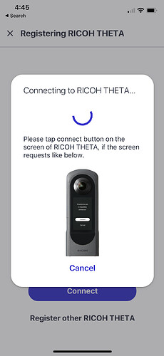

Screenshots from the setup, showing how it connects to the THETA and to the local network, all integrated well.
Did you use an iPhone? I had some problems with Android, Google Pixel 4a.
Yes, iPhone 12, running iOS 16.1.1. RICOH360 app version 1.2.3. THETA X firmware version 2.21.0.
