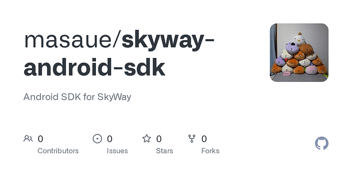

Get the code, build the apk, and install in THETA.

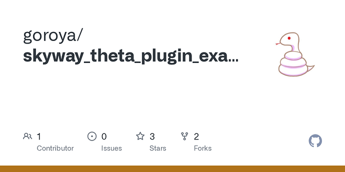

You can also use the repository from gogoroya
Changes to p2p-videochat
Add RICOH THETA Plug-in SDK to SkyWay-Android-SDK. Along with this, we will match build.gradle etc on SkyWay-Android-SDK side to RICOH THETA Plug-in SDK
Throw Intent to that effect with onCreate () so that you can control the camera from SkyWay-Android-SDK
